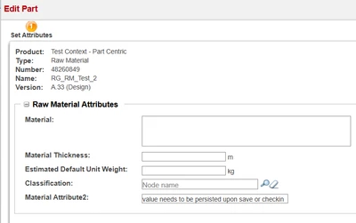

Version: Windchill 12.1
Use Case: I have a custom String attribute on WTPart, and need a data utility where users can edit the attribute value and check-in the part. How to persist the value entered by User in EDIT UI and save it?
Description:

This is the custom Data Utility I have which is registered correctly to the Material Attribute2, and the value entered there is not being saved. I'm using OOTB edit form processor.
public class MyCustomDataUtility extends DefaultDataUtility
	private static Logger logger;
	static {
		try {
			logger = LogR.getLogger("MyCustomDataUtility");
		} catch (Throwable throwable) {
			throw new ExceptionInInitializerError(throwable);
	@Override
	public Object getDataValue(String component_id, Object datum, ModelContext mc) throws WTException
		Object result=super.getDataValue(component_id,datum,mc);
		if(ComponentMode.VIEW.equals(mc.getComponentMode(mc.getDescriptor())))
			 return super.getDataValue(component_id, datum, mc);
		else if(ComponentMode.EDIT.equals(mc.getComponentMode(mc.getDescriptor())))
			logger.debug("EDIT Mode");
			TextBox tb = new TextBox();
			tb.setId(component_id);
			tb.setName(component_id);
			tb.setWidth(40);
//			tb.setValue("this has to be value what user enters in the EDIT UI");
			return tb;
		return result;

I'm using OOTB form processor with a custom string attribute on the WTPart.

If you use own data utility to show the edit column and you define the datautility information correctly,
then the wizard save the information to the database without any additional customization.
If you do not use ootb edit wizard, then you have to write own code to save the value to the database.
