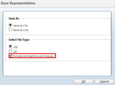

I did some testing with the method I described above. I can get a list of the filenames in the rep, but it does not include annotation files. In the UI, when I save the rep I have the option of including annotations:

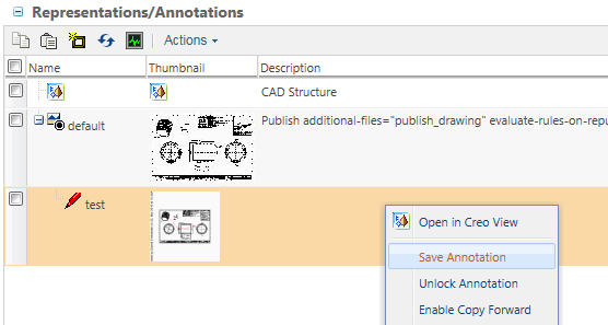

And I can save an annotation like I can save the rep:
But, I don't know how to use the VisualizationHelper and ContentHelper to do it.
Darrell13-AquamarineAuthor
March 23, 2016
Figured it out. Used ViewMarkUpHelper.service:
