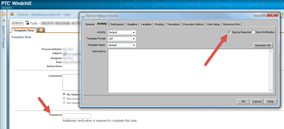

I want to put a password verification for a workflow task , who ever get that task to complete, first enter password then only they can complete the task.

mohit raghuwanshi‌,
In the workflow template, make sure you check the box "Signing Required".  Screenshot below.  Please mark as correct if this answers your question.  Or else let us know if you have any further question.
