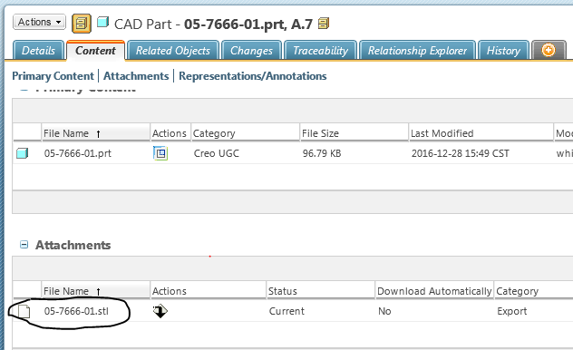

Hello All,
I have a task in which i am to read data of attachment file(which is an xml file). can somebody guide me how i can achieve this. Is there any InputStream related API?
December 28, 2016
Do you mean you want to get the marked file(your file name is xxxx.xml) via API?
December 29, 2016
Hello Chen,
Yes, basically i am using xml file for attachment, I am to read that xml tags in that file using APIs and generate UI based on those tags.
December 30, 2016
I don't know how to read it online, but you can download it.
cadDoc is the host of the attachments.
EPMDocument latest = (EPMDocument) wt.vc.VersionControlHelper.service .allVersionsOf(cadDoc).nextElement();
ContentHolder holder = ContentHelper.service.getContents(latest);
Vector contents = ContentHelper.getContentListAll(holder);
Then you can traverse the contents then find the attachment and download it.
ContentServerHelper.service.writeContentStream((ApplicationData) contents.get(i), fullPath);
