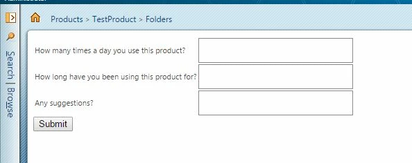

Hello Everyone,
I am new to windchill customization. I am to write a custom page, in which i am show some questions and text area for answers, and a submit button. I am to take those question and answers and pass to server when user clicks submit button and page should get redirected to Product folder page.
Till now i am able to create custom JSP page using HTML and JavaScript. i have made submit button using action tag in JSP. Can somebody guide me how i can achieve this or better way to achieve this. please refer the attachment.

Hi Gajendra Rainger‌,
I tried this in very limited use case and found that you can do something like this.
  1. First get/retrieve Product OID programatically.
  2. Once you have OID, you can then generate static URL something like below:
    1. http://<Windchill_Host>/Windchill/app/#ptc1/tcomp/infoPage?oid=OR%3Awt.pdmlink.PDMLinkProduct%3A218107&u8=1
    2. Note the URL pattern. Only OID is changed for every product. Rest is same.
  3. One you have this URL, you can then pass it to window.location attribute as below:
<html>
  <body>
  <form action="" method="POST" >
  How many times a day you use this product? <textarea rows="2" cols="50" name="first_name"></textarea>
  <br /><br />
  How long you have been using this product for? <textarea rows="2" cols="50" name="last_name"> </textarea>
  <br /><br />
  Any Suggestions? <textarea rows="2" cols="50" name="last_name"></textarea>
  <br /><br />
  <input type="button" value="Go Here" onClick="window.location = 'http://<Windchill_host>/Windchill/app/#ptc1/tcomp/infoPage?oid=OR%3Awt.pdmlink.PDMLinkProduct%3A218107&u8=1';">
  </form>
  </body>
</html>
