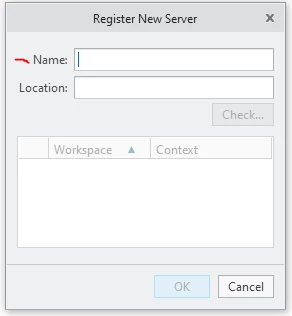

How to register automatically the server name?
  • November 23, 2021
  • 5 replies
  • 2547 views
As per this thread, related issue.
Do you kwon how to register automatically the server name?
Thx

This is how we do it. In your startup script we have:
If Not Exist "%PTC_WF_ROOT%\.ssappd\ServerMgr\.srv_mgr_db3.fldx" robocopy "%SERVER_DIR%\creo7\configs" "%PTC_WF_ROOT%\.ssappd\ServerMgr" /r:0 /NDL /NJH /NJS /nc /ns /if .srv_mgr_db3.fldx
If the user hasn't logged into Windchill then it copies down a .srv_mgr_db3.fldx which has a default workspace that everyone has access to and is set to "no server". Doing this makes sure that everyone is using the same Windchill server alias.

Does this work for Windchill 11.2 ?
I tried and it does not seem to work.
Any pointers are appreciated.

Chris works with me. We have used this for 11.1 and Creo 4. We are now on 12.0.2 and Creo 7 and had no issues with it. We have a batch file to start Creo as a shortcut on user's desktops. This sets up a few things like copying config.pro files down and creates the server connection if missing. Yes, this does work but the batch file sets up those environment variables first.
