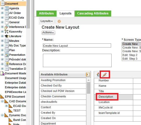

How to remove scrollbar in a multiline string attribute in Windchill?
Version: Windchill 12.1
Use Case: get rid of scrollbars in text area
Description:
This is a String attribute of limit up to 500 characters on a WTPart.
this field has to be editable, so do not want to make it read-only.
Can we get rid of the scrollbar?

Hi @11025060
You can set the size of the input frame
So set a number of lines and the scrollbar disappears. But if the number of rows is overcome, then the scrollbar will appear again. PS: there is no mechanism to avoid this behavior.
If you need it in some ootb Wizard, check a layout settings in Type and attribute management.
Go to the layouts find your attribute in a grid and click on it.
Select a pencil and new window shows others options to set a size of the input string frame
