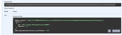

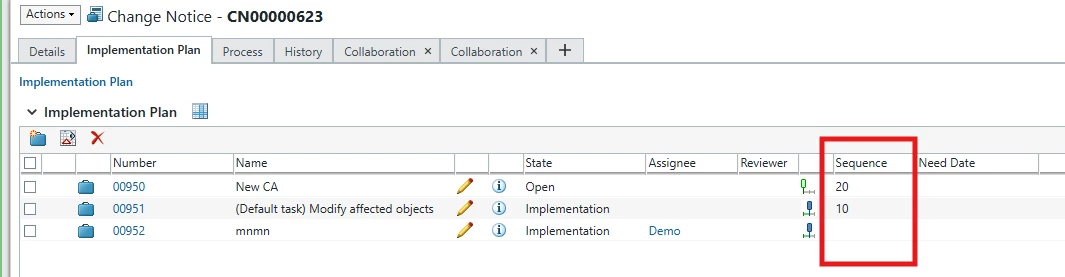

I need to programmatically retrieve the Sequence value of a Change Activity (WTChangeActivity2) as it appears in the Change Planning / Execution Plan. Currently, the only method that works is executing a direct SQL query on the CHANGEPLANACTIVITY table.
Example SQL (working):
SELECT parent.SEQUENCE
FROM WTCHANGEACTIVITY2MASTER cam
JOIN WTCHANGEACTIVITY2 ca
    ON ca.IDA3MASTERREFERENCE = cam.IDA2A2
JOIN CHANGEPLANNINGLINK cpl
    ON cpl.BRANCHIDA3B5 = ca.BRANCHIDITERATIONINFO
JOIN CHANGEPLANACTIVITY cpa
    ON cpa.IDA2A2 = cpl.IDA3A5
LEFT JOIN CHANGEPLANACTIVITY parent
    ON parent.IDA2A2 = cpa.IDA3PARENTREFERENCE
WHERE cam.WTCHGACTIVITYNUMBER = ?
However, this is not a supported API approach, and I want to avoid SQL.
I also tried using:
ChangePlanningHelper.modifyPlan(...)
Map<VersionableChangeItem, String> changeSeqMap
But this map only accepts sequence values for updates — it does not expose or return the current sequence.
changeSeqMap.get(ca) always returns null.
Question:
Is there any supported Windchill Java API (ChangePlanningHelper, ChangeHelper2, WTChangeActivity2, Info*Engine, etc.) that allows retrieving a Change Activity’s sequence number without using SQL?
If yes, please provide an example.
If not, can PTC confirm that SQL is the only available method?
Thanks in advance.

Hello @SP_12330653
you can use this :
String sequenceNumber = (String) ChangePlanningHelper.getService().getExecutionValues(changeNotice).get(task);
 String CNNumber = "CHN00000001";
 String taskNumber = "00001";
 WTChangeActivity2 task =null;
 WTChangeOrder2 changeNotice = null;
 QuerySpec qs = new QuerySpec(WTChangeOrder2.class);
 qs.appendWhere(new SearchCondition(WTChangeOrder2.class, WTChangeOrder2.NUMBER,
 		SearchCondition.EQUAL,CNNumber , false),new int[] { 0 });
 QueryResult results = PersistenceHelper.manager.find(qs);
 if (results.hasMoreElements()) {
 	changeNotice = (WTChangeOrder2) results.nextElement();
 	QuerySpec qstask = new QuerySpec(WTChangeActivity2.class);
 	qstask.appendWhere(new SearchCondition(WTChangeActivity2.class,WTChangeActivity2.NUMBER,
				SearchCondition.EQUAL, taskNumber),new int[] { 0 });
 QueryResult resultsTasks = PersistenceHelper.manager.find(qstask);
 if (resultsTasks.hasMoreElements()) {
 	task = (WTChangeActivity2) resultsTasks.nextElement();
7 replies

Imad_A13-AquamarineAnswer
Hello @SP_12330653
you can use this :
Thanks, it Worked.
