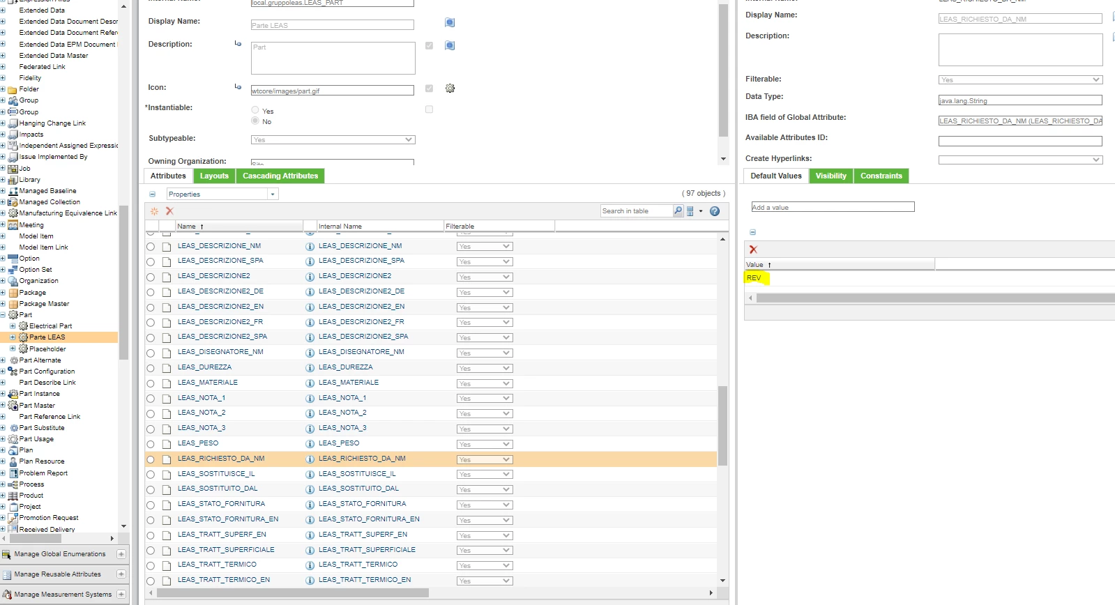

I set a default value which should fill in the field on creation (see photo 2)
Creating a wt part without the cad is ok

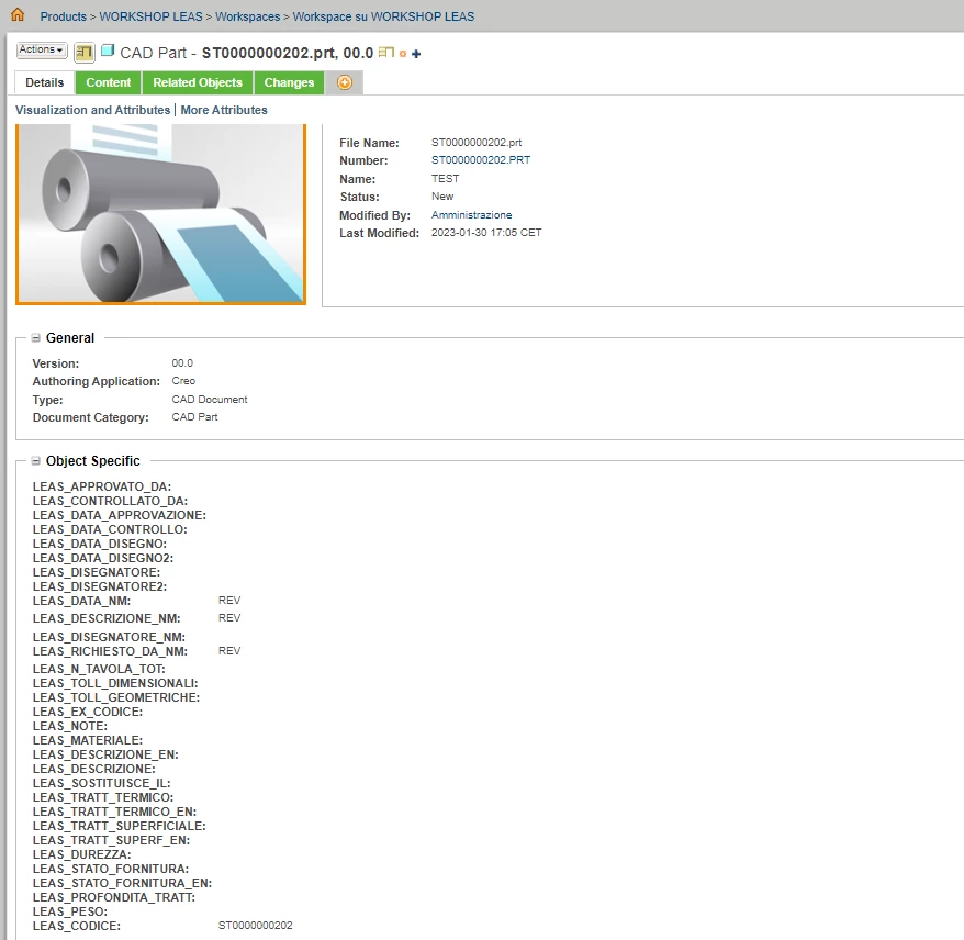

Creating a Cad Document with Creo Parametric is ok (see photo 1)

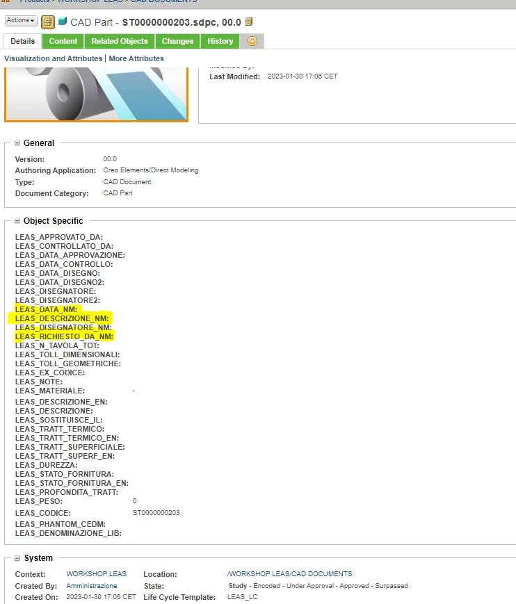

When creating a Cad Document with Modeling the fields with the default value are not filled in (see photo 3).
How to set a default attribute with CREO MODELING?

It works only if you create CAD document from a web Wizard in workspace.
If you create CAD from Creo the default value is not propagated from Windchill to model.
You need to specify the default value in a start model which is used to create model.
PetrH

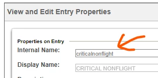

I found what I was missing, at least in the enumerated list case.
If the CAD start part has the attribute mapped and the default value of the attribute in CAD is the INTERNAL NAME of an attribute on the list instead fo the display name, then it works (at least in Creo and NX).
@Matteo_1987 , I'm not super familiar with Creo Modeling but if the behavior on this aspect of it is the same as is in Creo or NX try putting in the Internal Name as the text in your CAD model. The attribute looks to be already explicitly mapped.
