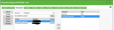

Hello All,
I want to make Particular group of user should be the always reviewer and approver for the object during promotion request.
Is it possible through configuration.
Thanks.
@HelesicPetr
November 8, 2023
1. Create a group with approvers:
2. Create an Approval task with Approver role:
3. Add the Promotion Approvers group to the resource pool of the Approval task with Approver role:
4. Check the role setup:
You can assign task directly to a group, but it feels more logical for me to work with roles:
