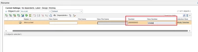

Version: Windchill 12.1
Use Case: I have written custom listener will use the event "IdentityServiceEvent.PRE_CHANGE_IDENTITY" for if WTPart New Number is NOT 10-digit validation and not able to dispay the conflict description message in Event Console
Description:

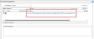

@Vishwa_RADDI ,
I saw your post and it seemed very doable.
I renumbered a WTPart to be 6 characters long.
As expected, I get a failure and the error description is exactly what I coded.
Seems to work to your spec, unless I'm misunderstand your post.

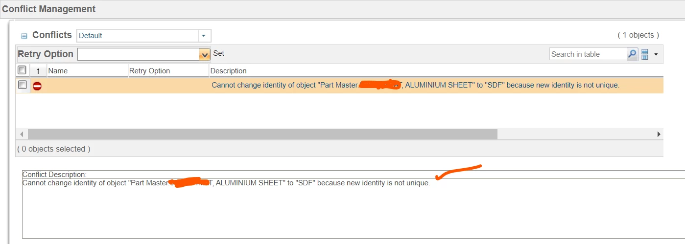

Jun 11, 2024 12:19 PM UTC
Hi David,
how do you set this custom message on Conflict event console? I have tried using WTException(new WTMessage); and just throwing an exception its not working. let me know how do we set?

Hi @Vishwa_RADDI
It is more complicated then just throw WTException.
You should create object a ConflictException with a ConflictElement that contains a ResolutionType and a ConflictType with your message to a user.
I did similar exception for deleting WTPart that is linked to a process plan. User has a option to repeat and finish deletion or nothing else.
