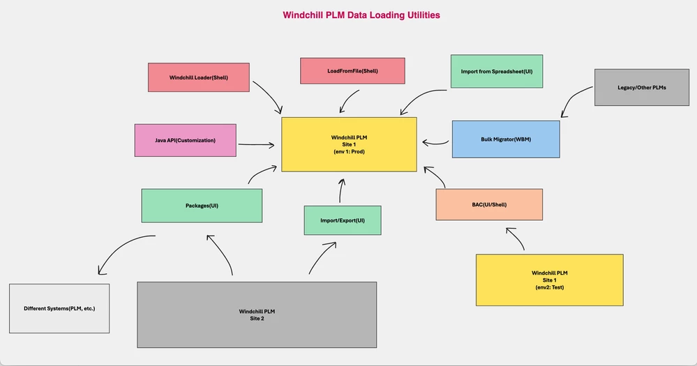

As to data loading, this is another topic, it's usually more business or configuration than customization, unless if you are dealing with the Bulk Migrator, custom loader, or Java APIs:
All data loading tools except one are collected in this illustration:
Unfortunately, the above illustration needs a session to be explained!
