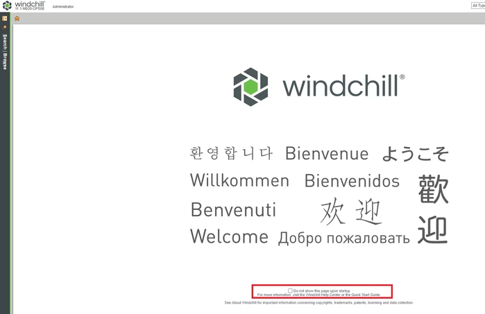

How to use only "plm.lightbreeze.ml" to go to the home page.
How to use only "plm.lightbreeze.ml" to go to the home page instead of using the suffix "Windchill/app"

How the "It Works" page looks like.

Do You mean that you don't want to use the name Windchill after slash?
You would like to just use address of server?
If So, then you need to change a page "It Works" with redirect script,
But it will work just for browsers, not for Creo where /Windchill has to be used.
You should know small background how a Tomcat works. The /Windchill is a pointer to a web application

I remember when I install Windchill. I can change the address of the home page. But as you said, I need to make a redirect script. But I don't know how to.I've only used Springboot before. Windchill is a little bit tough for me.

Hi @guide_me
Do you mean a welcome page? You just want to directly show Windchill home page with tasks and so on?
if so in Windchill 11.1 there was a checkbox to do not show welcom page again.
