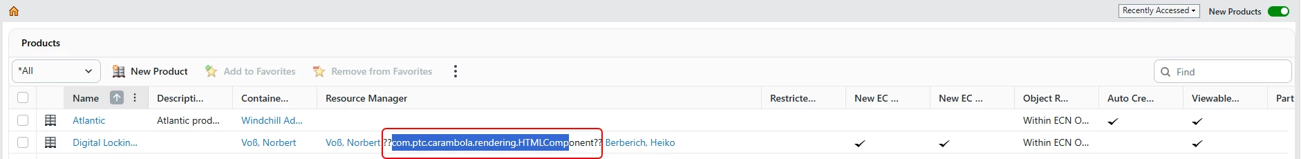

Jun 18, 2026 1:14 PM UTC
When I turn on the toggle “New Products” on top right corner in Windchill 13, instead of displaying a semi-colon ; it is throwing
??com.ptc.carambola.rendering.HTMLComponent??
Any idea what could be the root cause for this? TIA

Hello, have you tried to clean browser cache?
