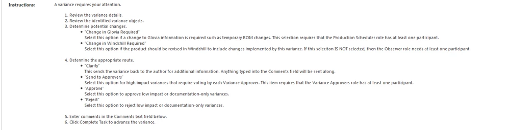

I want to use HTML lists to create a better experience for my users and have succesfully done so.  Here is that code:

The quirks that I ran into exist, I assume, because this field (instructions field in the activities tab of the work item) is meant for plain string input with some html formatting such as <b></b> for bold.
Quirks:
  1. A return after a list declaration will result in a blank list item.
    • Start your first list item immediately after starting the list block.
  2. Completing a list item <li> with it's </li> will result in a blank list item following your actual list item.
    • No idea why this happens, but simply do not use </li> </dt> or </dd> tags.
  3. Each list block <ul> <ol> or <dl> must be terminated.
    • Despite the above behavior for list items, the lists themselves must be termated with their </ul> </ol> or </dl> tags.
I hope this information helps others out there as it took a bit of discovery on my end.
