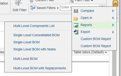

I am facing an issue with one custom action
Hi ,
I am facing an issue with one custom action, Somehow action misplaced in wrong model but even after adding in correct model (psbRelatedPartsTreeToolBar ) that action is not populating in required model is getting added again on same place where it was earlier and in my action there no custom class we have custom JSP over there .
Requirement : "Custom BOM Report" action should be under report section below the "Multi-Level BOM with replacement" action

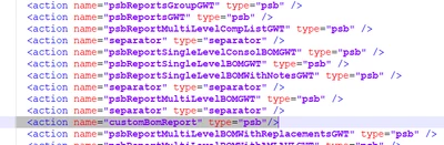

May 30, 2024 9:08 AM UTC
Hi HelesicPetr,
Thank You for your quick response & I got the solution on it
for that I followed the below mentioned help center article
 https://support.ptc.com/help/windchill/r12.1.2.0/en/index.html#page/Windchill_Help_Center/customization/WCCG_BusLogicCust_ReportGeneration_ReportSelection.html
Please find Attached Snapshot here , I have added custom action under Reports section of Structure tab which are PSB actions.

May 29, 2024 10:58 AM UTC
Geetting same output even after renaming , reloading actions and restarting windchill
Action:  <action name="customBomReportGWT" ajax="component">
Model Action :  <action name="customBomReportGWT" type="psb"/>
HelesicPetr
May 29, 2024 11:50 AM UTC
Hi @New_10867550
There is one trick how to move the action to the group.
here is an example
<action name="ReportAVGWT" type="AVENG">
 <ribbonInfo buttonType="menuitem"/> <!-- AVENG CUSTOM desinition that button is in the group menu reports-->
</action>
