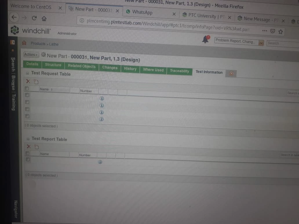

I was working in a project where I should only show a particular subtype of Document in a table. I was putting my code for that and finally I got the table but the contents inside the table ie Name of the document or Number of the Document are not visible. Here I am attaching my code and I am sending the pic of that can anyone say what is the alteration I should do in this code to make my contents in the table.

Best answer by BjoernRueegg
The problem is the QueryResult
Please change the method
public QueryResult buildComponentData(ComponentConfig config, ComponentParams params) throws WTException {
--> to
public
Object buildComponentData(ComponentConfig config, ComponentParams params)
and change the end of the method
QueryResult qr= PersistenceHelper.manager.find((StatementSpec) qs);
return qr;
--> to
return new
WTArrayList(PersistenceHelper.manager.find((StatementSpec) qs));
August 24, 2021
Following needs to be set to false, since you don't have a configurable table:
table.setShowCustomViewLink(true);
I would first remove all the not needed columns, just to check if it works. e.g. the state, strikeThrough and also remove the javascript (PTC.carambola.customCompareFunction)

I have removed those and tried it still same problem is there.
