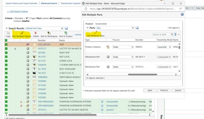

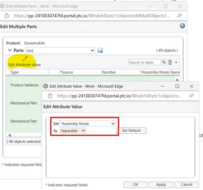

easiest way is to run a search and use edit multiple objects :
select all objects and use edit attribute value :
