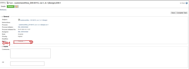

i want to customize the workflow activity task jsp page
I created the attribute called customer name inside the WTDocument. the value of the attribute should be updated once the activity get completed.
i wanted to add the dropdown list inside the workflow activity task page, It contains some customer names like A, B C, D based on the selection of the user from the dropdown list it should be persist into the customer name attribute.
please help me to solve this. if some have any code snippet please share.

Jul 3, 2024 11:38 AM UTC
Hello ,
I wanted the dropdown as i mentioned in the given below image. I gone through the suggested article dropdown is not coming.
HelesicPetr
Jul 3, 2024 11:41 AM UTC
Hi @RaikarRaghu
So you have done something wrong.
It works.
for example if you forgot set the properties by windchill shell and forgot to use the propagation
xconfmanager -s wt.workflow.definer.variable.ShowWfEvolvableWarning=true -t codebase/wt.properties -p
