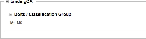

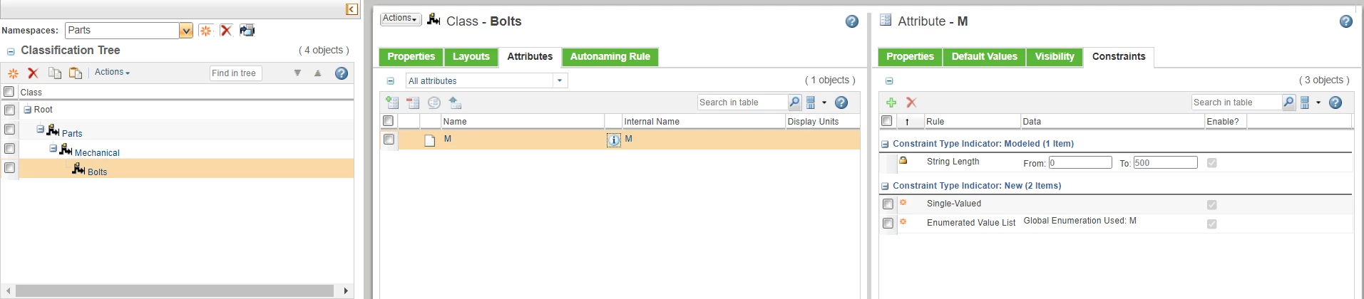

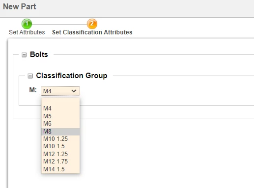

Use Case: i have the string attribute called "Cappio" it has update based on the classification attribute value. step 1: I created the Classification tree, in the Bolt node i created the attribute "M" it having the enumeration list. Step 2: i need to retrieve the attribute value, update in the "Cappio" attribute using Persistable Adapter
Description:

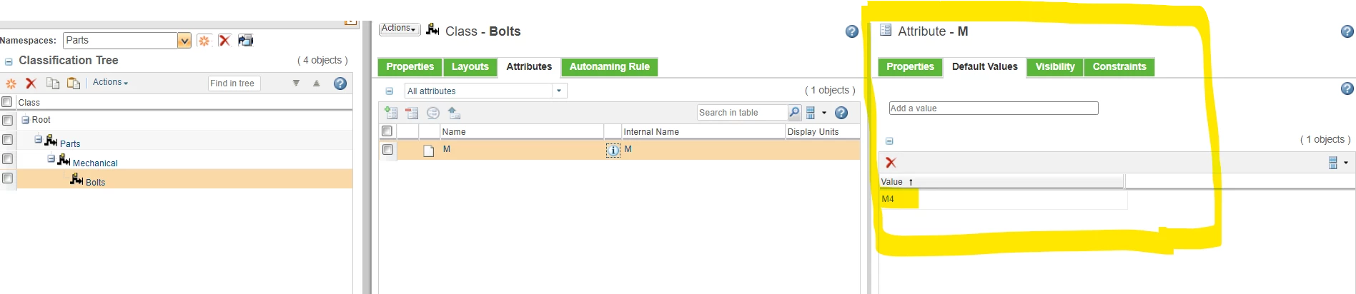

# I am getting the default value of the attribute, but i don't want the default value i need the value that is stored in the attribute
