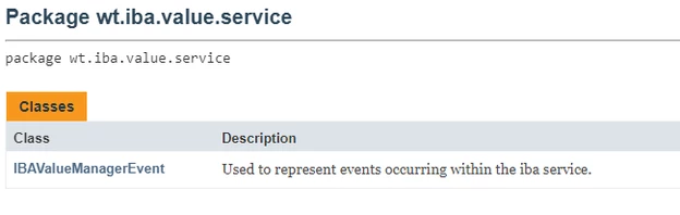

Hi @Pushpak
All supported API are listed in a javaDoc documentation
So if your package and function is not part of the javaDoc, then it is not supported.
CS17101 Client JavaDoc
and your class IBAValueDBService is not part of the javDoc in Windchill 13,0
there is just IBAValueManagerEvent
PetrrH
