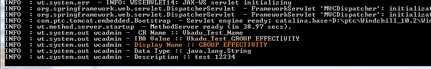

Use AttributeTypeSummary API to get this Data types for attribute defined on any object type.
PersistableAdapter obj = new PersistableAdapter(cr, null , Locale.US,null);
      /* load attribute */
      obj.load("GROUP_EFFECTIVITY");
      Object enumValue = obj.get("GROUP_EFFECTIVITY");
      System.out.println("IBA Value :: " + enumValue);
AttributeTypeSummary ats = obj.getAttributeDescriptor("GROUP_EFFECTIVITY");
      System.out.println("Display Name :: " + ats.getLabel());
System.out.println("Data Type :: " + ats.getDataType());
      System.out.println("Description :: " + ats.getDescription());
Output will looks like below:
