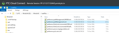

load below file and restart your server :

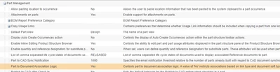

What preference is missing and what version are you running
Buiꓘa
DKWc15-MoonstoneAuthor
January 4, 2024
The below highlighted preference is missing.
windchill version using is 12.1.2.4

Fadel23-Emerald IIAnswer
23-Emerald II
January 4, 2024
