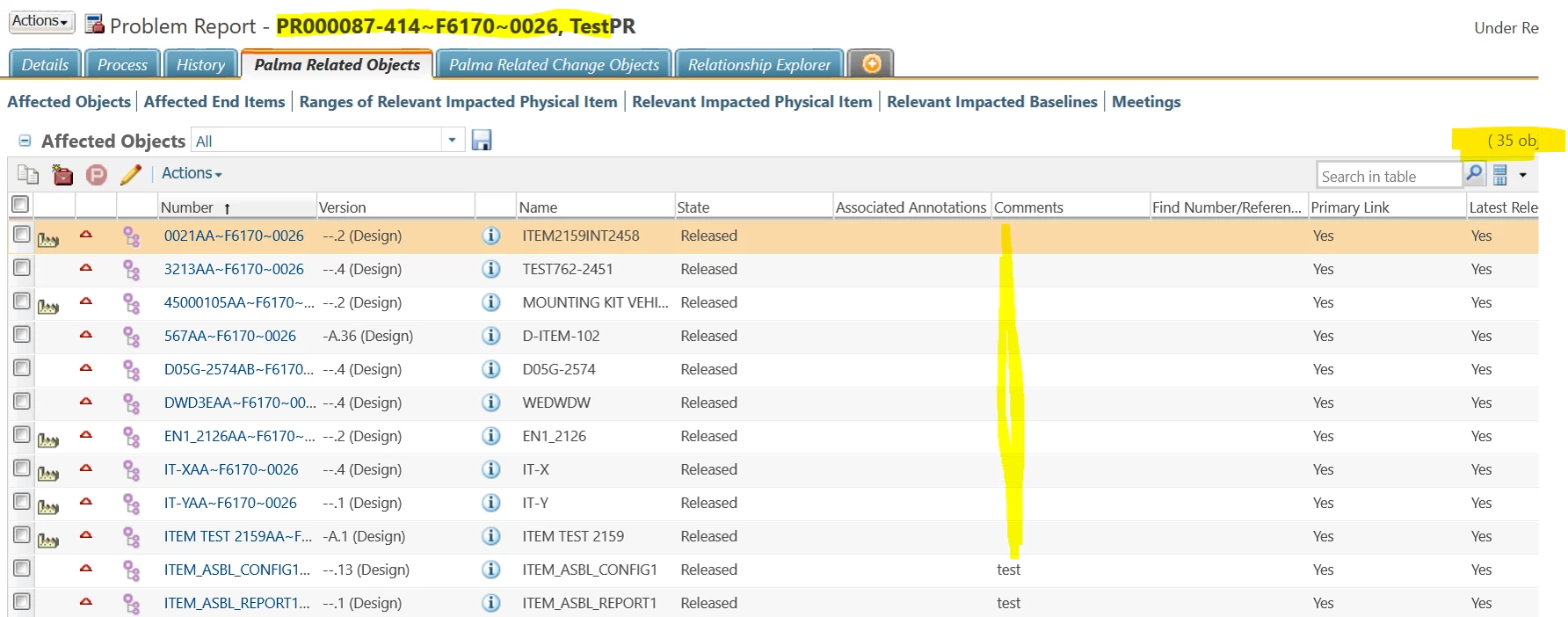

Use Case: Create Problem Report > Add affected objects(add more objects) > add comment to each affected object > Click on Finish to create the PR. Issue is not with 1 or 2 affected objects. When we have more number of object in affected object tab, then the issue reproduces with comment missing for few object in list.
Description:
Navigate to Product, select more objects(selected 35 objects), add comment for all and create Problem Report. Once the PR is created, go to related objects tab, and check the list. For some affected objects, the comment is missing in the table. Refer screenshot.

I am not sure about that article but I tried a test on my system (different version - 12.0.2) and it appear to work normally. I added 52 items to the PR and each one with a comment. I finished and looked at the saved object, affected object tab and it showed correctly all comments. Could this be related to the customization? Is there a way you can test your system, version for version, without this customization?
