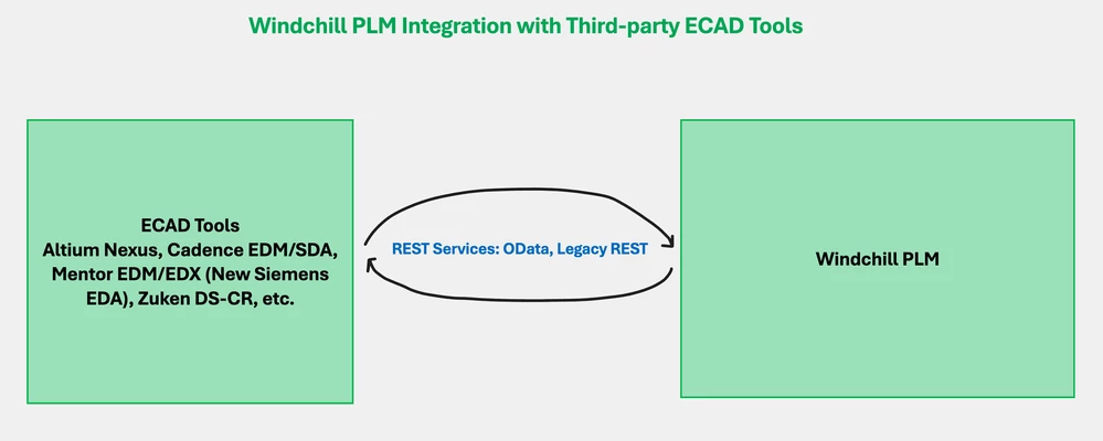

@MT_11904685 here is a summary.
Workgroup manager for ECAD has been retired.
Now, all ECADs should integrate with Windchill through REST Services.
The integration should use as much as possible the new OData framework, RESTEasy is legacy and no longer supported, however, PTC still does offer some specific endpoints in the legacy framework that manage eCAD Documents​​​​, they are only open and supported for PTC Partners.
See:
https://www.ptc.com/en/support/article/CS254366 Hub for Windchill REST Services (WRS)
https://www.ptc.com/en/support/article/CS239492 Hub for the retired WWGM for ECAD
https://www.ptc.com/en/support/article/CS406984 Hub for the new integration of ECAD through WRS
best regards,
Tarik

Oct 11, 2024 5:09 AM UTC
Hi @MT_11904685 ,
Windchill REST Services(WRS) does not support managing contents of CAD Documents via REST Endpoints.
You can refer to Help Center Topic: PTC CAD Document Management Domain
The domain does not support upload/download of Primary Content Files of CAD Documents which needs Windchill Workgroup Manager.
