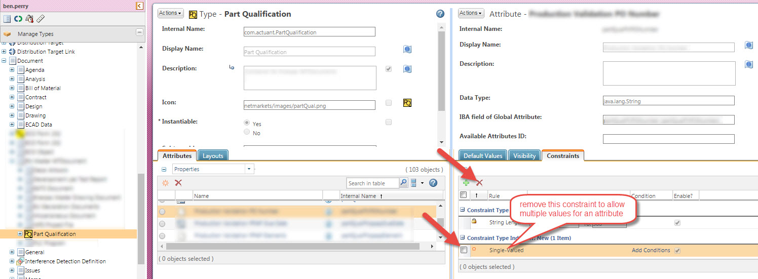

Hi All,
Is any way to capture multiple values for a single attribute in Windchill as like "Check box" functionality.
I have a Attribute which might have multiple values. how we can do this in Windchill.
Vivek
BenPerry
December 30, 2016

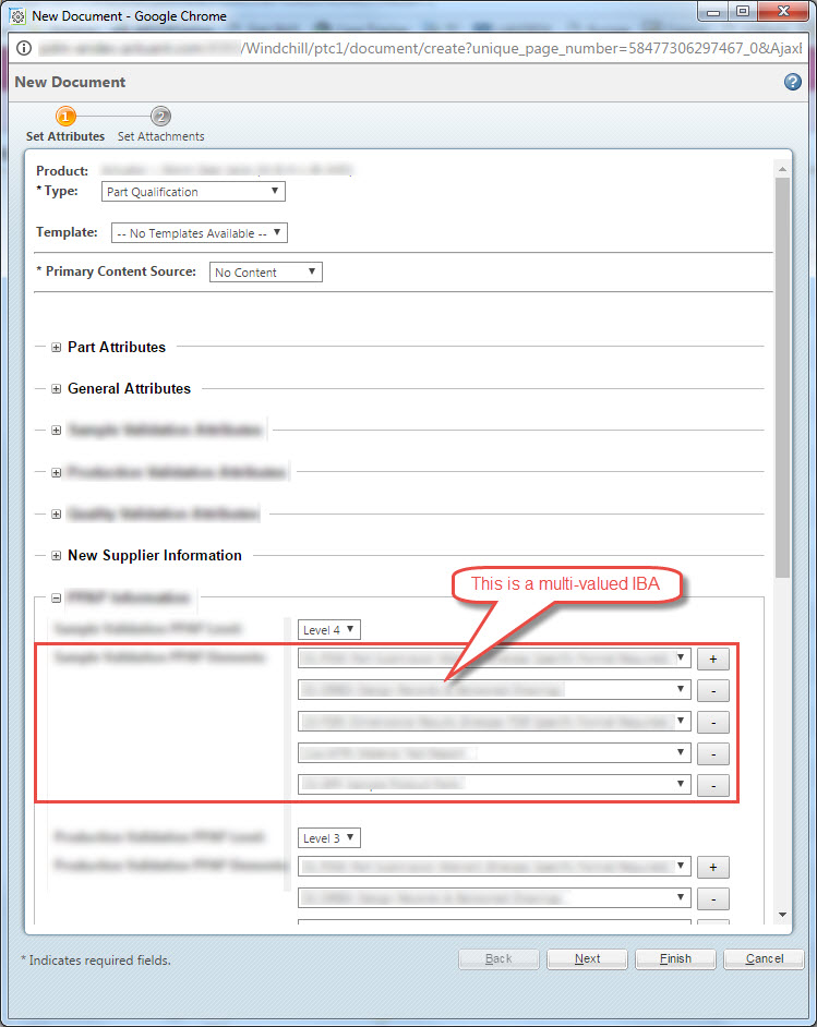

Vivek Uchekar‌,
By default, most attributes have a "Single-Valued" constraint.  Just remove this constraint in Type & Attribute Manager.  There are examples below.  Does this answer your question?
