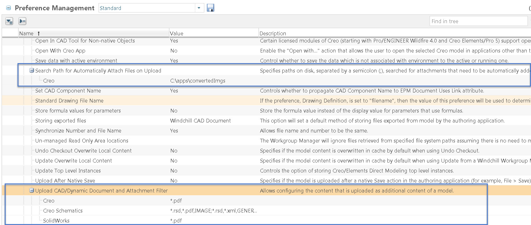

Am exporting a 3D pdf for a model in creo using our Custom Application developed by JLink. But i want that pdf should be attached to the corresponding WTPart of the model.
Thanks in Advance!!
2-Explorer
February 17, 2017
I am not sure whether it is possible with WTPart with out a customization. But you can attach the PDFs to the model using the below preference under workgroup manager.
Once it is uploaded to server, you can use an expression in your release workflow or by a listener, copy the content from models to WTParts.
