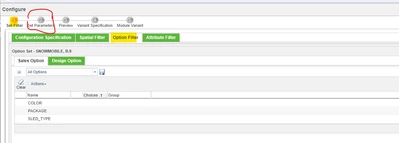

I know that we can drive values of a parameter based on the option value populated, I wanted to know if it is possible to update the choice of an option based on the parameter value?. Please pour your thoughts.

Windchill cannot do it, refer to https://www.ptc.com/en/support/article/CS411953

Nope this doesn't  make sens OOTB  , the ATO config filter is coming BEFORE for the  advances logic
