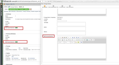

I also have the Same issue and Trying to get the Proposed Solution on Change Task Wizard  =using Alias Attribute

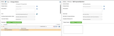

try this create a string IBA on CN call it Myproposedsolution
on below example its called MyProposedSplution (there is a typo, ADHD side effect)

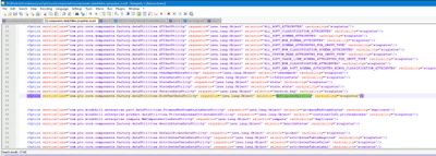

in below file  Windchill\codebase\com\ptc\core\components\components.dataUtilities.properties.xconf add line

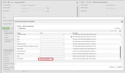

<Option serviceClass="com.ptc.core.components.factory.dataUtilities.RichTextDataUtility" requestor="java.lang.Object" selector="MyProposedSplution" cardinality="singleton"/>
run a xconfmnager -p + restart
in the CN layouts add the DU edit attribute properties
On the CN you should be able to see the attribute on create and info Page :

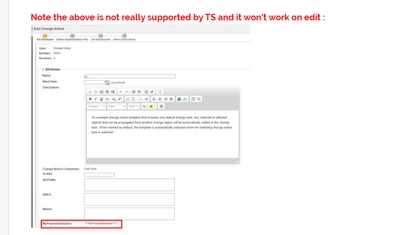

Note the above is not really supported by TS and it won't work on edit :

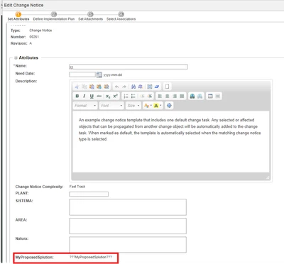

Jan 2, 2025 5:40 AM UTC
I followed the same steps.
Like this , on Change Notice page I'm getting the value for Attribute "??UnAssigned" . Still not able to resolve .

Jan 2, 2025 8:05 AM UTC
I have the same :
This all we can do OOTB , as workaoround you can remove that attribute from the Edit layout .

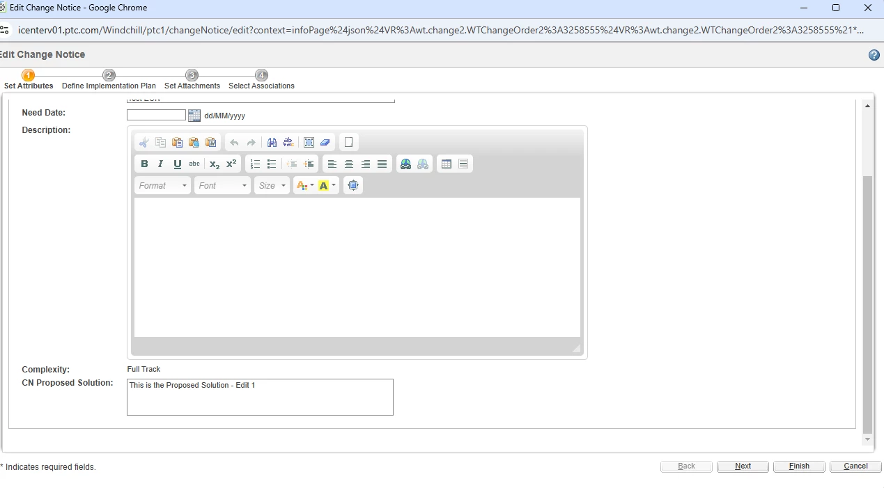

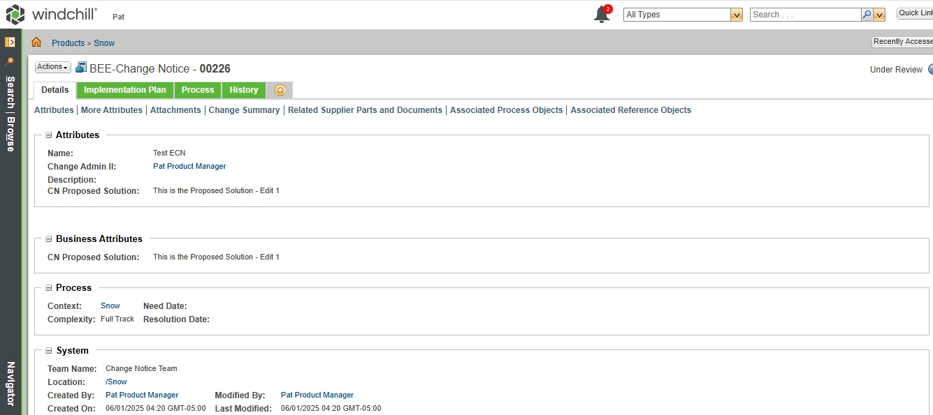

Jan 6, 2025 9:24 AM UTC
You may create that attribute in the CN.
I did a quick check.
See the screen shots - create screen and edit screen of my CN.
I think it should be possible on the CT also, I just checked in CN.
What is the process you followed?

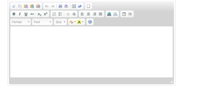

you have added a string attribute , we need a Rich text one like this one :
