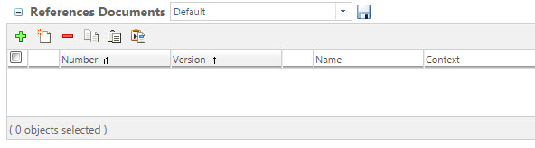

NITHYA MANJUNATHAPPA‌,
Are you loading the documents into Windchill as WTDocuments?  If yes, then you would likely use the Reference link.  If you look at the WTPart information page, the link to the document should be created in the "References Documents" table.
