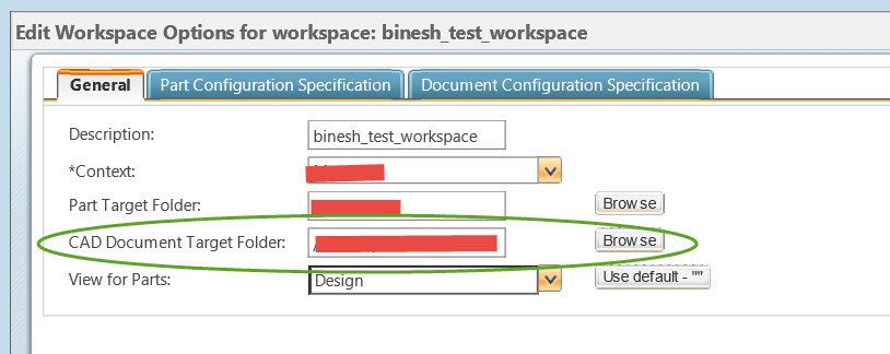

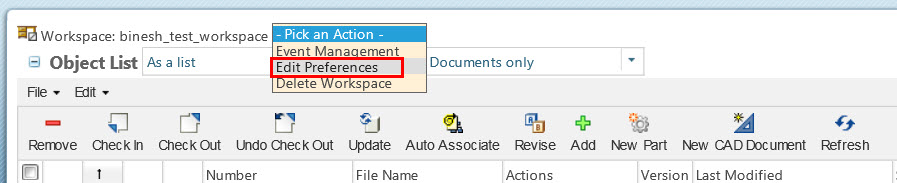

Feb 27, 2017 2:28 PM UTC
In your workspace, go to preferences, you can set  a default folder for all your CAD data checked in from that workspace.

2-Explorer
Feb 27, 2017 5:00 PM UTC
Hello John,
