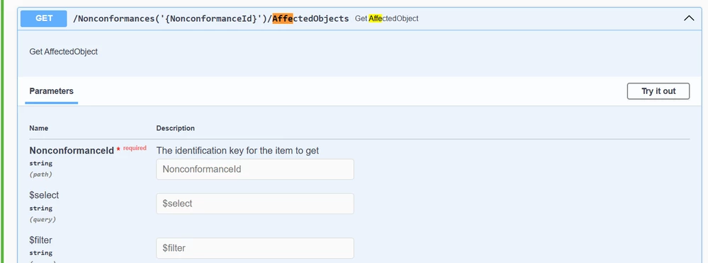

Is there an API to retrieve affected objects for a nonconformance in Windchill QMS
Is there an API to retrieve affected objects for a nonconformance in Windchill QMS through the code
Fadel
FadelAnswer
23-Emerald II
Mar 13, 2026 1:53 PM UTC
we have a REST endPoint for that
Java API no supported one exist https://www.ptc.com/en/support/article/CS242156

Hi @Fadel how could I call this rest api in java code to fetch the affected objects.
Fadel
23-Emerald II
Mar 16, 2026 8:17 AM UTC
Yes  we have WRS  Caller , see https://www.ptc.com/en/support/article/CS462498
