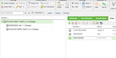

is there any api to get only parts which are present in part structure
is there any api to get only parts which are present in part structure tab or any other way if api is not present. for reference see the pic attached below.
Aug 16, 2024 9:03 AM UTC
You need to define a navigation criteria for exact this filter. You have chosen "Latest, Design, Working" then you need to filter the structure with this criteria.
Or you can save this filter and find this navigation criteria based on the user and name.
Afterwards you can call the API
Persistable[][][] wt.part.WTPartHelper.service.getUsesWTParts( WTList parts, NavigationCriteria navigationCriteria )

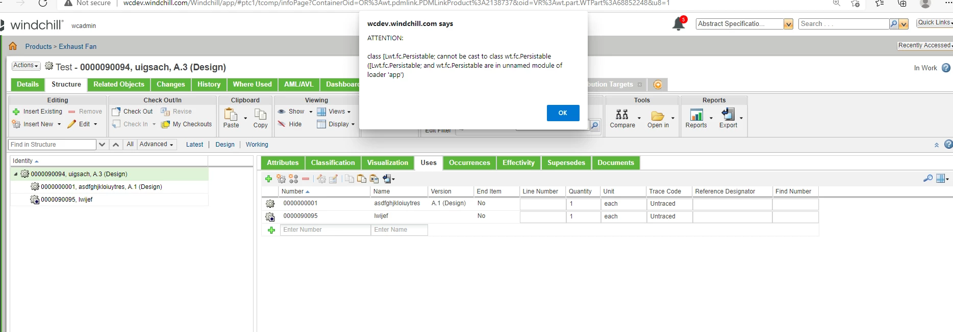

I tried with the given solution. it is showing the type cast exception.
Image is attached
This is the code i am using.
wt.query.QuerySpec qs = new wt.query.QuerySpec(NavigationCriteria.class);
qs.appendWhere(new SearchCondition(NavigationCriteria.class, NavigationCriteria.SHARED_TO_ALL,
SearchCondition.IS_FALSE), new int[] { 0 });
qs.appendAnd();
qs.appendWhere(new SearchCondition(NavigationCriteria.class, NavigationCriteria.NAME, SearchCondition.EQUAL,
"Test"), new int[] { 0 });
QueryResult qr = PersistenceHelper.manager.find(qs);
System.out.println("Size ************************* " + qr.size());
NavigationCriteria nav = null;
while (qr.hasMoreElements()) {
nav = (NavigationCriteria) qr.nextElement();
System.out.println("Name of NAvigation criteria " + nav.getIdentity() + ",T " + nav.getType() + ",N "
+ nav.getName() + ", A " + nav.getApplicationName());
QueryResult pp = wt.part.WTPartHelper.service.getUsesWTParts(part, nav);
System.out.println("PP Size " + pp.size());
while (pp.hasMoreElements()) {
Persistable obj = (Persistable) pp.nextElement();
WTPart pt = (WTPart) obj;
Aug 19, 2024 1:32 PM UTC
@RaikarRaghu
You need to check if it's really a WTPart or a WTPartMaster. Your screenshots shows me, that one part is a master and not a iteration.
