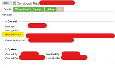

Is there any API to get Rule Definition from Choice Rule?
Version: Windchill 12.1
Use Case: I have a scenario where I'm supposed to get Rule Definition from ChoiceRule. Row Object: com.ptc.windchill.option.model.ChoiceRule Lets say My Column I'm trying to get is "atoRuleDefinition"
Description:

Hi @Manoj_Dokku4
I believe that the API exists
OptionsClientHelper.service.getLocalRulesOnSourceChoiceForOptionSet();
OptionsClientHelper.service.getGlobalIncludeEnableRuleOnSourceChoice();
OptionsClientHelper.getATORuleConfigSpecs();
generally check the OptionHelper methods
