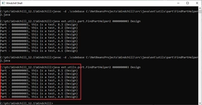

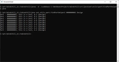

The trick is at use order by to set the order of the QueryResult such that the first object in the QueryResult is the object you want.  You simply return that first object.  No need to use a while loop.
In the images below I show the order the iterations occur in the QueryResult.
Latest rev.iteration to first rev.iteration

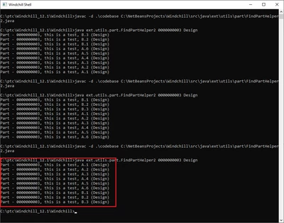

Now, suppose I want the latest version first but with first iteration, B.1, B.2, B.3, A.1, you get the idea.
I simply flip the sort order, and I get the new ordering.
If I want A.1 first (first iteration to latest iteration) I flip the sort order again and I get the results I want.
