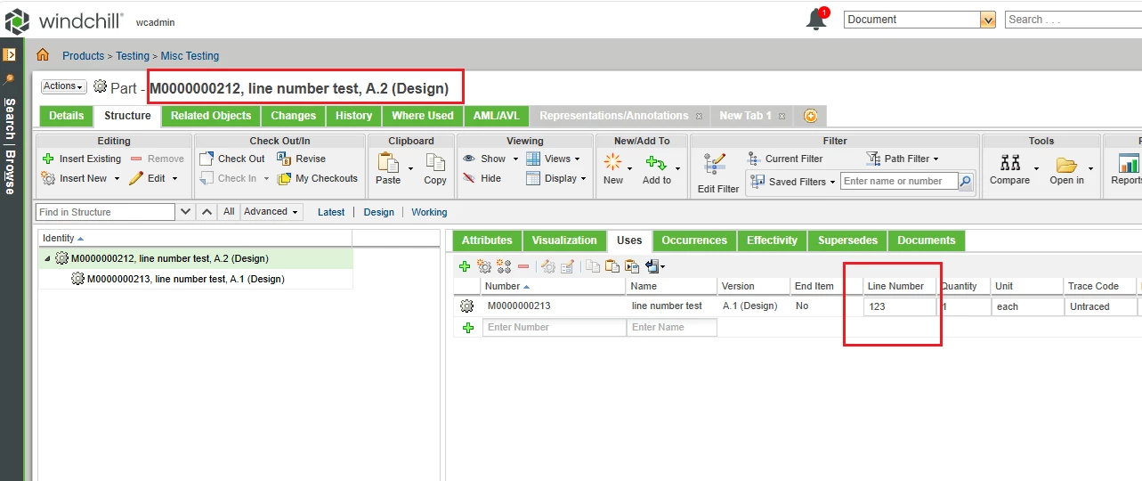

Before delete the structure page displays the line number 123.

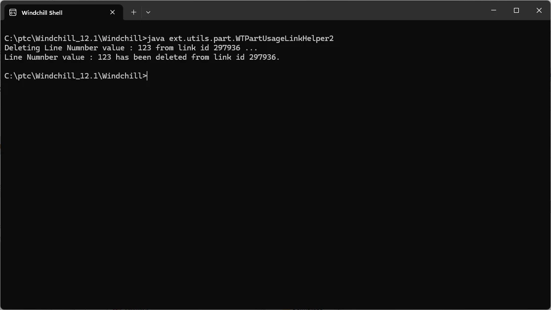

I run the code in a Windchill shell which shows the line number has been deleted from the link.

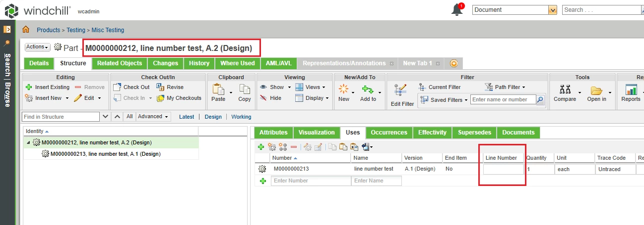

Next, I refresh the structure page and we see the line number has been deleted.
Note the WTPart was NOT iterated yet the line number is deleted.
