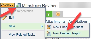

Subtype of Change Review (called Milestone Review). I want users to create Problem Reports against the review to document issues found while completing the review using a subtype of a PR (Review Finding).
Ideally, even from the Action menu I would like the selection to be "New Review Finding" instead of "New Problem Report" when being created against the "Milestone Review" subtype.
Alternatively, when "New Problem Report" is selected, I would like it to default to "Review Finding" as the subtype in the New PR wizard
