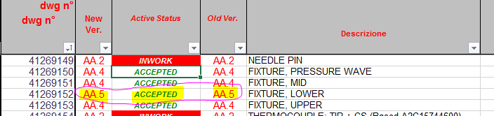

Little database, to "Read only" data from WINDCHILL.
I have a Little excel database, and I would like to read the "Status" and the "Version+Iteration" of drawing.Little Database
Also the description, maintaining some kind of Read-Only link from Windchill, I suppose that somethiing like DTI "DEsktop integration"  that do an OOTB from office applications, but is possible to do ?

@Marco_Tosin shared link if for the document itself ( not data inside ) right ?
IMO Desktop integration cannot do that.
@mbuonfiglioli you need to make a report
Report can be exploited directly or linked as data source in excel.
