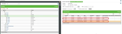

Use Case: Items set to obsolete can't be shown in the Workspace. They are also not visible in Creo Elements Direct Modeling.
Description:
I can't find the setting for obsolete items downloaded to the workspace.
We've got a Standard context where obsolete items are shown and visible.
And we've got a Engineerings context where obsolete items are not shown and not visible for our users.
I would like to change that behavior.

This sounds like a question for your Windchill administrator. "ACLs" control what actions the user can do with data in various states. It sounds like some actions are not allowed for Obsolete files, like maybe download.
Mar 24, 2025 10:09 AM UTC
Hello Joe,
I've looked into the acces control rules. I've changed the acces for "Mechanical Part" and "MCAD Document" to Read, Download.
Problem is, I still can't find obsolete items if I use the search option in Windchill.
One little sidenote, for both context, obsolete items are not shown and visible.
joe_morton
Mar 24, 2025 3:55 PM UTC
Check the ACLs specifically in your Engineering Context, since it seems that's where the issue is. You may have an ACL that is denying some access.
