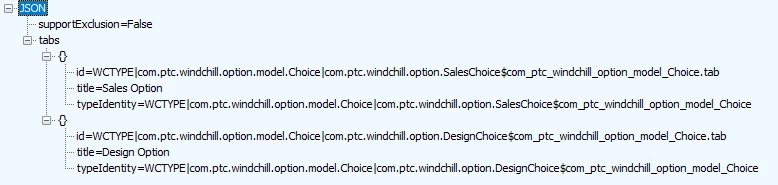

For Manage Choices Wizard, there is a table builder invoked in that wizard. That table builder contains Tabs in it namely, Alternative parameter value, option code, Status parameter value, structure section value. I want to reorder that tab sequence to-be generate after opening the wizard or want to customize such that always the option code tab will be opened at the first. Relative file: ato-component.js

    You are correct that ato-component.js is the relevant file for customization. The ATO.components.ChoiceComponent.renderPanelContext function handles the JSON response from the POST /Windchill/ptc1/choiceCompTabs request. You'll need to perform your own sorting/reordering on the JSON object itself (var json) or the JSON array (var tabItems) so that when the tabs are rendered they are in the desired order.
    Please let me know if you have any questions regarding this and if this approach works well for you.
