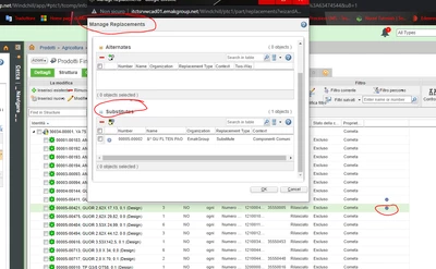

Is it possible to use manage replacement operation in more BOM?

Hi @Matteo_1987
As I know this is not possible,
This function is available just in one BOM.
If you need to replace part in multiple bom you have to use a change notice process where you can do a multiBom change.

Hi Petr,
using mass change the replacement occurs immediately as if you used the replace with existing part command. The manage replacements function, on the other hand, indicates using the replaced component once the initially existing one has been used up.
