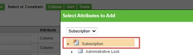

joe_morton
June 9, 2023
To add to Marco's answer:
If you add the Subscription Object to the "Select or Constrain" tab, it will give you a link to the Subscription in the report results. Once you click on that link, you will be able to delete it (with the right permissions, of course).
Add this:
It should look like this when added:
Report results now include a link to the Subscription, where it can be deleted:
