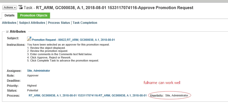

I have taken many tests and postalAddress attribute can't work because  postalAddress  is not stored in WTUser database table which is stored in Windchill Directory Service ldap. If we use like "fullname" which can work. So suggest to give up it.
I write mapping field as this : primaryBusinessObject^wt.maturity.PromotionNotice~creatorRef^wt.org.WTUser~fullname

I know you want to get postalAddress info. What I mean is that we can't mapping the attribute which is not stored in WTUser table. It is not related with HTML text.  postalAddress is stored in ldap not in WTUser table so mapping can't get it.
