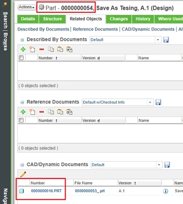

I figure out how to do this using only OIRs.
I start with WTPart and Owner associated CAD Doc that have different numbers.  The starting numbers are irrelevant.

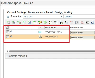

I select Save As from the WTPart's action menu and then I include the CAD Doc.

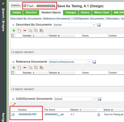

I select Ok and a new WTPart and CAD Doc are created both having the same number. Well, almost the same, the CAD Doc also has the ".PRT" on the end of its number 😊
So, this is possible to do using OIRs.
