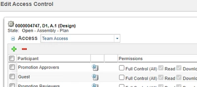

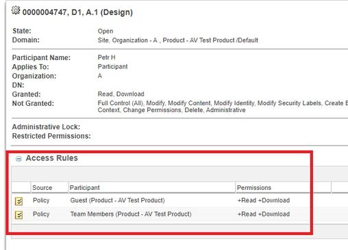

It is not so obvious but you need to check real ACL access on the object where you have a issue.

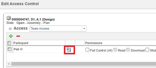

you need to go to the object and use an Edit Access Control to see what ACL are defined for the user
With a green plus add a specific user to the list and check the access for that user
And check detail by Info button

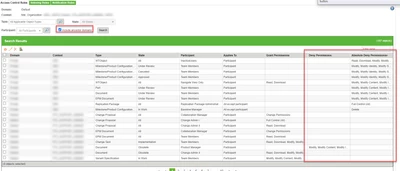

In the Context go to Utilities > Policy Administration
Make sure to checkmark the "Include Ancestor Domains" box and click search. This should include all policies that apply (Site, Org and Context).
If you want to filter down by object type for simplicity - that is possible as well
Something to think about is that policies can be applied based on all (applies to everyone) or to a role and "Team Members" is a role that encompasses anyone on the team that is in a defined role. Policies can also apply to the participant, or all except participant. My hunch, is there may be a policy created that prevents a normal user from changing an identity once an object has been to a specific state (like Released). That is a CM best practice that you don't reidentify objects once they are approved for use.

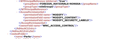

Sep 7, 2023 3:25 PM UTC
This is interesting.
It looks like the Team Template to create a context (Project in this case) has access controls in the HTML file?

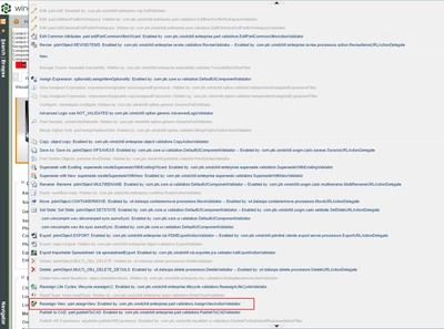

Hi @LG_10096154
Are you trying to figure out why the Actions > Reassign View is available for the user? If you enable jcaDebug on the details page of the part, you can find out which validator is being used to enable that action. I enabled it on my system, and it's showing that the com.ptc.windchill.enterprise.part.validators.AssignViewActionValidator is used to enable the action.
I took a look at the source code for that validator class, and it looks like the action will be enabled as long as the user has Modify permission on the WTPart on the latest iteration of every revision. It doesn't check the Modify Identity permission in this case.
