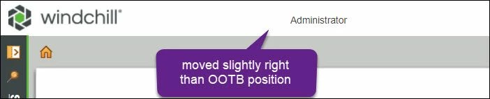

Is there any way to move the location of where the username displays in the banner?  We recently upgraded from 10.1 to 11.0.  The company logo I use is too wide in the new version.

Hi @STEVEG,
To do this follow below steps:
  • modify "C:\ptc\Windchill_11.0\Windchill\codebase\netmarkets\javascript\util\jsfrags\navigation\navigation.jsfrag" file and locate below line:
<table><tr><td><div id="logoNav" class="' + PTC.navigation.HEADER_CLASS + '"></div></td><td><span id="globalUser"></span></td></tr></table>
  • Add couple of &nbsp (HTML spaces) before globalUser element as shown below.
<table><tr><td><div id="logoNav" class="' + PTC.navigation.HEADER_CLASS + '"></div></td><td>&nbsp&nbsp&nbsp&nbsp&nbsp&nbsp&nbsp&nbsp&nbsp&nbsp&nbsp&nbsp&nbsp&nbsp&nbsp&nbsp&nbsp&nbsp&nbsp&nbsp&nbsp&nbsp&nbsp&nbsp&nbsp&nbsp&nbsp&nbsp&nbsp&nbsp&nbsp&nbsp&nbsp&nbsp&nbsp&nbsp&nbsp&nbsp&nbsp&nbsp&nbsp&nbsp&nbsp&nbsp&nbsp&nbsp&nbsp&nbsp&nbsp&nbsp&nbsp&nbsp&nbsp&nbsp&nbsp&nbsp<span id="globalUser"></span></td></tr></table>
  • Save these changes
  • Run below command from Windchill Shell:
ant -f bin\jsfrag_combine.xml
  • Make sure command run successfully
  • Stop Windchill Method Server
  • Clear Tomcat & Info*Engine cache
  • Restart Windchill Method Server
It will looks like below:
Note:
  • If need be, you may also have to clear browser cache too.
  • These are the instructions for your reference purpose only. Make sure you follow Customization best practices to avoid any maintenance/update/patch installation override.

STEVEG21-Topaz IAuthor
January 11, 2019
Thank you for that.  I have been so incredible busy since our upgrade because of problems with it, or end or year tasks that I haven't been able visit this community.  Things are starting so slow down now.  I didn't want to mark this as accepted yet until we can try it to verify it works.
