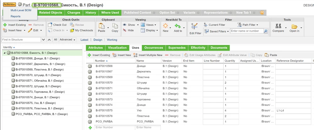

I would like to launch Multi-Level BOM report in Action menu of WTPart. In such case I added:
<model menufor="wt.part.WTPart" name="more parts actions" resourceBundle="com.ptc.windchill.enterprise.part.partResource">
<action name="psbReportMultiLevelBOMGWT" type="psb" />
</model>
into custom-actionModels.xml file.
After "Reload Action" such command is avaiable but report (new window) is not shown.
What else should be done to launch report??

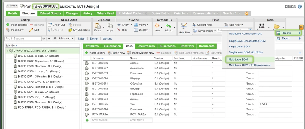

Gucio16-PearlAuthor
Nov 15, 2024 2:23 PM UTC
Hi Catalina,
in OOTB instalation to generate Multi-Level BOM report  you have to sellect:
I wolud like to have such possibility in Action menu (or after RMB clicking)
regards,
gucio
HelesicPetr
Nov 22, 2024 11:34 AM UTC
Hi @Gucio
You can not just take the action from a structure menu and add it to a standard object menu as you tried.
It does not work this way. The GWT action is not designated to be used anywhere.
The report input is from the structure so you should write own function to lunch that report with correct input then you can place the action in the menu where you need it.
PetrH
