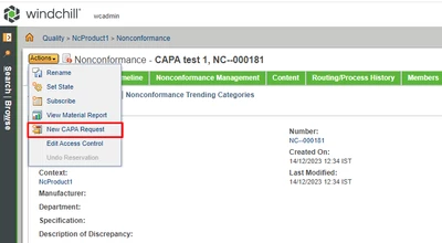

I have changed in CAPA oir , Im passing attribute value on CAPA name while creating new CAPA but that IBA is not present in Nonconfomance so how can I create CAPA?
<AttrValue id="number" algorithm="com.ptc.windchill.enterprise.revisionControlled.server.impl.NumberGenerator">
<Arg>CAPA-</Arg>
<Attr id="ext.xyz.LOCATION"/>
<Arg>-</Arg>
    <Arg>{GEN:wt.enterprise.SequenceGenerator:CAPAREQUESTID_seq:10:0}</Arg>
                </AttrValue>

The IBA should be presented on the new CAPA object. . .
if it is not there, then you can not use this IBA in the OIR or you have to create the IBA on the correct soft type object. CAPARequest...
