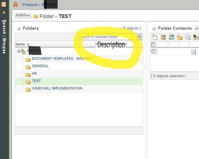

Good day
I would like to add another column in the Folders table (left pane) not the Folder Contents table (Right pane)
Currently the only column is "name" and i can only sort by name.
I need a description column that displays the description of the folder.
See attached picture

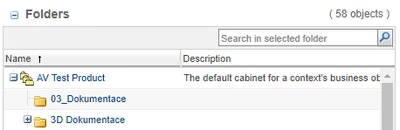

Best answer by HelesicPetr
Hi @Markh74
You can rewrite OOTB java class to add the description. After restart you can see the Description in the Folder tree
I just added two rows to the code
var5 = this.getComponentConfigFactory().newColumnConfig("description", "Description", false);
var3.addComponent(var5);
class folder place
WindchillFolder\codebase\com\ptc\windchill\enterprise\folder\mvc\builders
Windchill 12.0.2.3

				var7 = "Unable to obtain folder content table tableId!";
				log.error("buildNodeData(): " + var7);
				throw new WTException(var7);
			} else if (!"folderbrowser_tree".equals(var4)) {
				var7 = "Improper folder content table tableId: " + var4;
			} else if (var1 instanceof TreeNode && ((TreeNode)var1).name().equals("RootNode")) {
				FolderPageContext var8 = new FolderPageContext((JcaComponentParams)var2.getParams());
				Cabinet var6 = var8.getCabinet();
				var2.addElement(var6);
			} else {
				if (!(var1 instanceof SubFolder) && !(var1 instanceof Cabinet)) {
					if (!(var1 instanceof SubFolderReference)) {
						var7 = "node is not 'RootNode' or a Folder! node = '" + var1 + "'";
					var3 = (Folder)((SubFolderReference)var1).getObject();
				} else {
					var3 = (Folder)var1;
				FolderQuery var5 = FolderQuery.newFolderQuery(var3, var4, (ComponentDescriptor)null, var2);
				var5.retrieveFolderContents();
Do not forget to backup original class file
 PetrH
