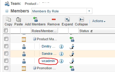

To add products to the list you will have to explicitly add users into the product team. Almost any role in a product will do the job, and we have dedicated groups/role just for ensuring visibility:
Give it a try and see if it helps.

I think wcadmin might need to be added to Org Admins.  Also it may not be a member of those Context teams.  Just a couple easy things to check.
James

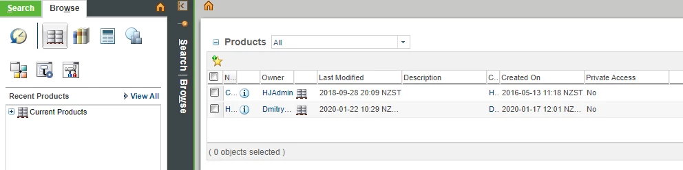

When I go to my Products list I see only two. They are the only products available for selection during Set Location for the Move Operation.
There is however a whole list of products that needs to show up during Set Location.

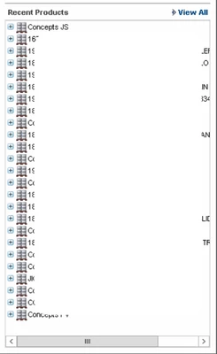

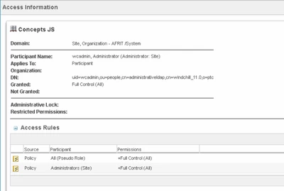

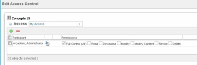

If I check correctly I should have have Full Control for the Concept JS product. What am I missing? Is there a reason for it not showing in my Products list and thus it is not available during Set Location?
Appreciate your assistance.

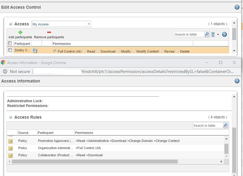

Just remember that you have to have enough access in both the source and the destination contexts to move an object. This may fall apart quickly if any of the contexts are created as 'private', or if you have 'deny' permissions anywhere.
What I would do in your place:
1. Create parts in both contexts in the same state
2. Go into 'Edit Access Control' and hit the 'i' icon to see the full list of all policies that govern the access control to a given object.
3. Check that you are granted with appropriate access and nothing restricts it explicitly.
Kind regards,
Dmitry.
